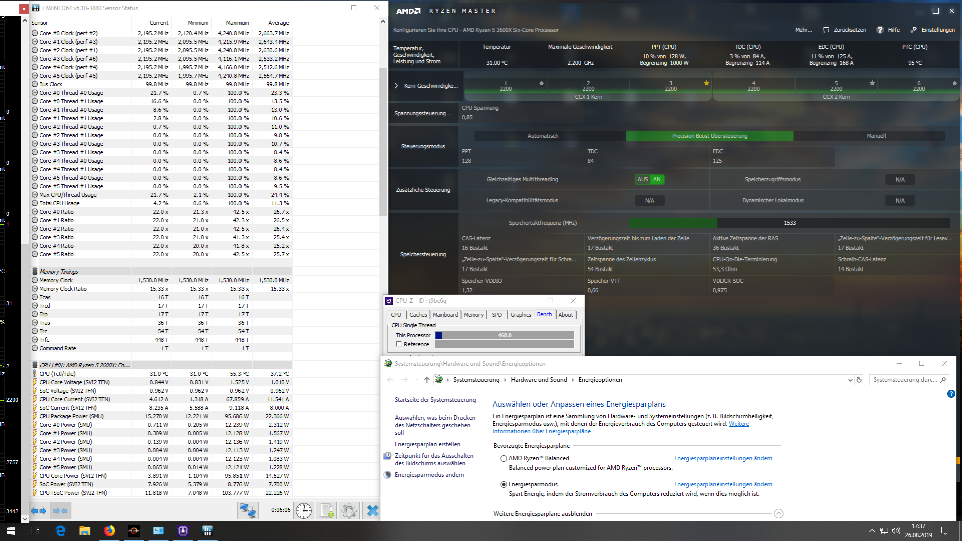

Asus X570 CH8 Formula AGESA 1.0.0.3 @ Bios Defaults und 3900X:
CB20 Singlecore: max. 4566.8 MHz
CB20 Multicore: 4142.2 MHz
