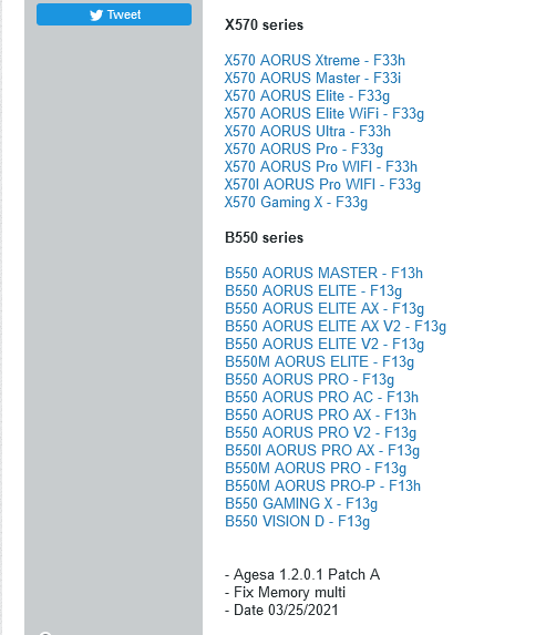

Neue Beta-BIOSe 2206 für Asus B550 und 3206 für X570 Boards
Please note that this is a beta BIOS version of the motherboard which is still undergoing final testing before its official release. The UEFI, its firmware and all content found on it are provided on an “as is” and “as available” basis. ASUS does not give any warranties, whether express or limited, as to the suitability, compatibility, or usability of the UEFI, its firmware or any of its content. Except as provided in the Product warranty and to the maximum extent permitted by law, ASUS is not responsible for direct, special, incidental or consequential damages resulting from using this beta BIOS."
https://www.hardwareluxx.de/community/threads/ultimative-am4-uefi-bios-agesa-Übersicht.1228903/#2.2
- Update AMD AM4 AGESA V2 PI 1.2.0.1 Patch A
- Fix USB connectivity issue
