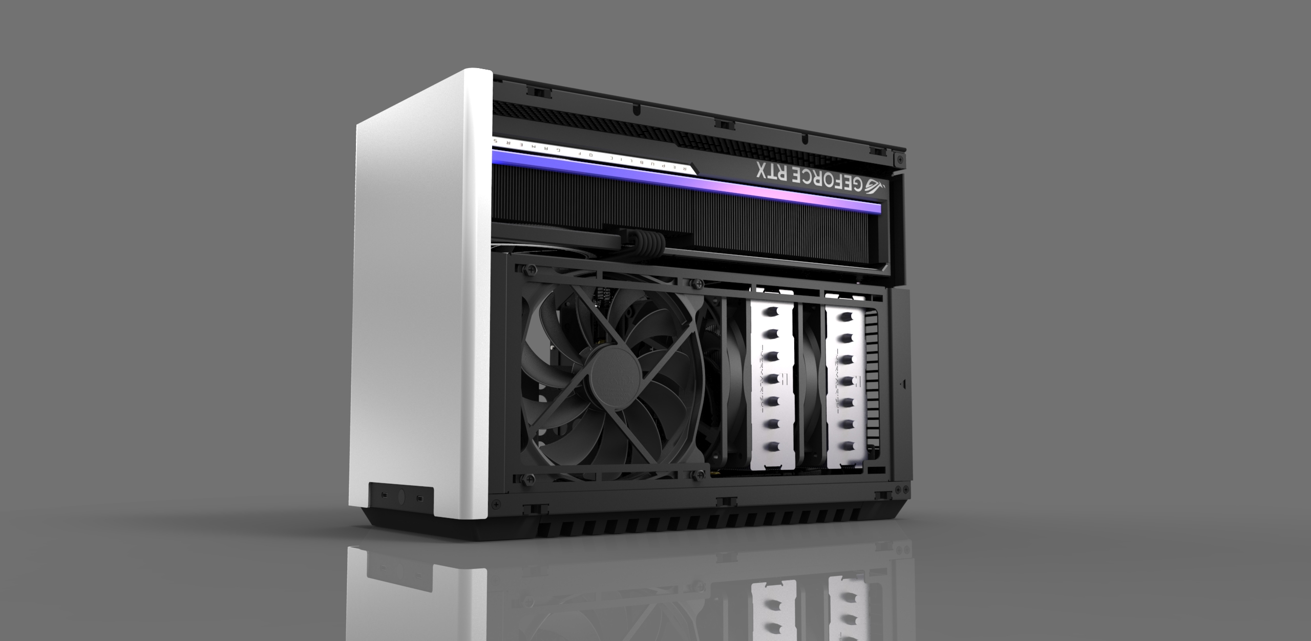

Asus Rog Astral + Thermalright PA120SE does fit in the C4-MATX (16.65L)
Reaktionen: ALPHA-S, Computafan, MaverickM und 2 andere

C4-MATX, Asus ROG Astral 5090, Thermalright PA120SE
