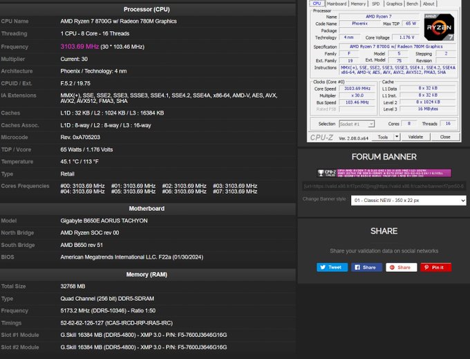

Gigabyte Achieves DDR5-10346 Memory Overclock With AMD Ryzen 7 8700G APU Running on B650E AORUS Tachyon
https://wccftech.com/gigabyte-ddr5-10346-memory-overclock-amd-ryzen-7-8700g-apu-b650e-aorus-tachyon/
