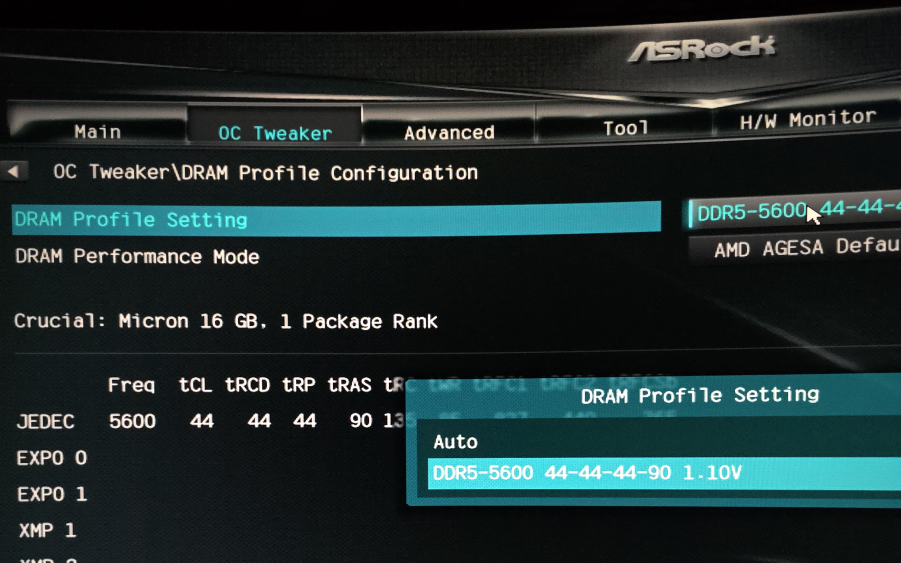

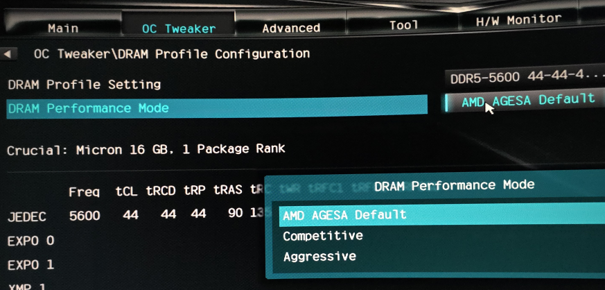

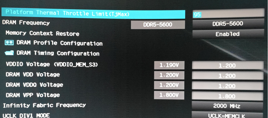

Added BIOS pictures. Today black screen even with the 4800
What about not loading the XMP, just change the voltage and the Mhz by yourself to check without faster timings? - Okay, I can try. What do you suggest?
Everything else is stock.

Additional info:
Today I repalced current RAM Kingston Fury 2x16GB DDR5-6400 CL38 - KF564S38IBK2-32 / https://www.kingston.com/datasheets/KF564S38IBK2-32.pdf to Kingston Fury 2x16GB DDR5-5600 CL40 https://www.kingston.com/datasheets/KF556S40IBK2-32.pdf and chose XMP 5600 - About 1 hour to play and black screen. Now I chose XMP Auto and the speed is 5200 - Let's see what happens.
I also tried another X600 mobo - same.
I'm not that knowledgeable about this whole memory thing, but if someone could direct me more specifically to what memory settings to set in the BIOS, I could try.
