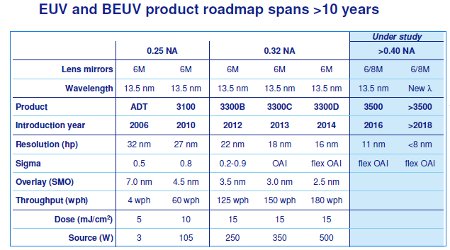

Auch interessant:
ASML outlines EUV roadmap at 13.5nm and 6xnm wavelengths (Source: Company)
http://escf.ieis.tue.nl/system/files/Documents/Workshop22November2011/ASML.pdf
