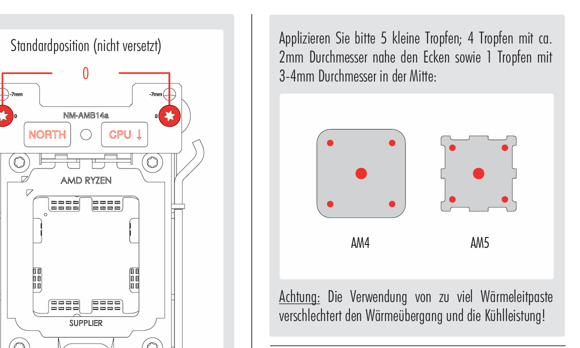

https://www.noctua.at/en/products/nh-d15-g2/downloads
