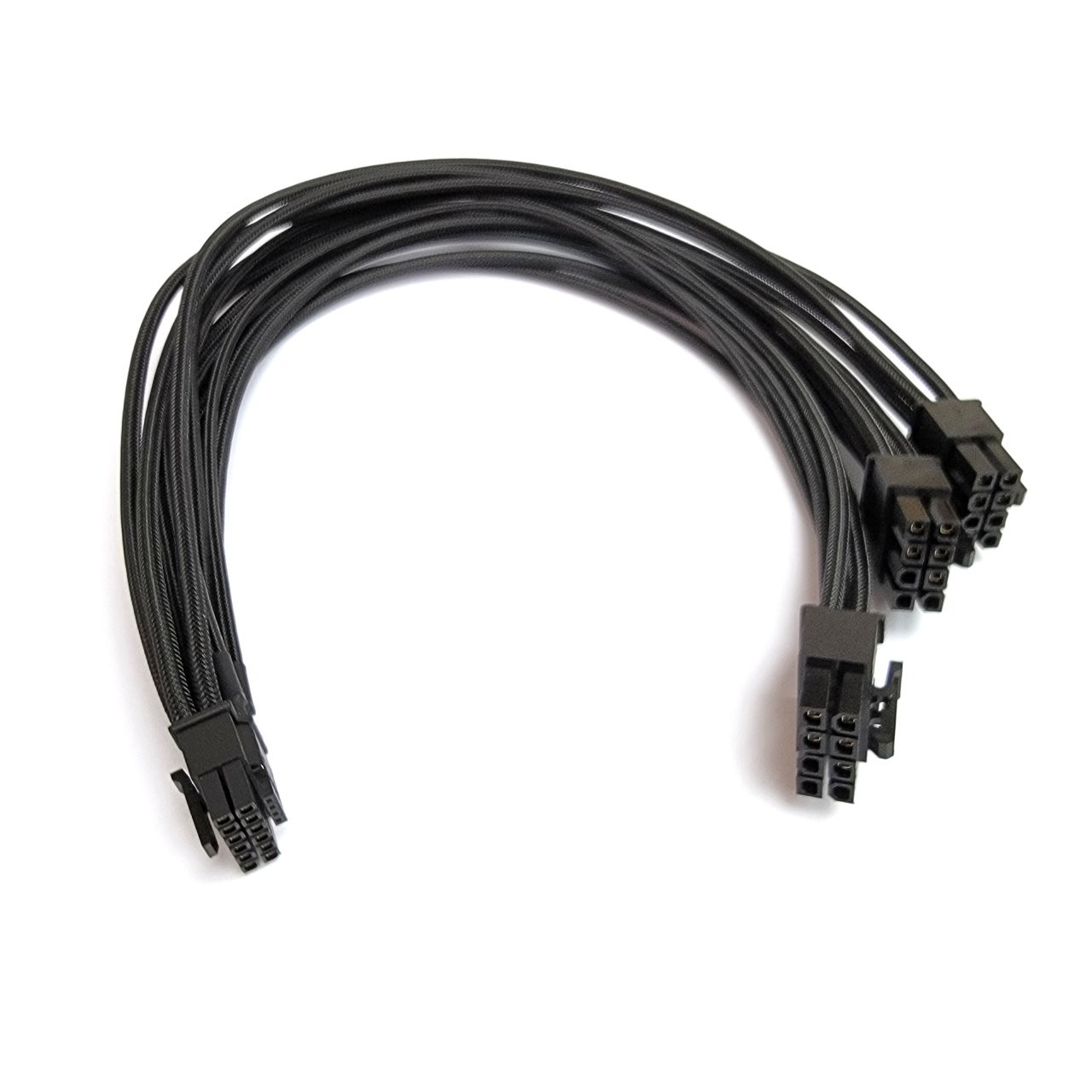

We are pleased to announce the release of our new 12V-2X6 cables, designed specifically for the recently launched RTX50 series GPUs. As of 2025, the industry standard has transitioned to 12V-2X6, replacing the previous 12VHPWR standard. Our new cables incorporate significant advancements, including enhanced terminal and connector housing materials, along with thicker wires, to provide an additional safety buffer for the latest GPUs.
The latest 12V-2x6 "H++" power connector recently made debut on the NVIDIA GeForce RTX 40 SUPER series GPUs and offers slightly higher power delivery versus the existing 12VHPWR "H+" connectors.
12V-2×6 "H++" Connector Offers Up To 675W GPU Power Delivery Versus 600W 12VHPWR "H+" Plug.
