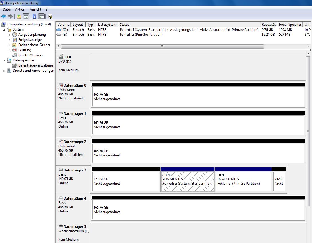

Alle 4 Platten sind sofort brav angelaufen.
Anbei Screenshot und Textdatei.

RAID Metadaten:
Code:
[SIZE="3"][FONT="Lucida Console"]Analyzing: C:\Downloads\witty RAID5\harddisk1.txt
Analyzer Version: 2009072701
===== RAID MPB INFORMATION ===== when MaxLBA=976773168 then from Sector==>976773166 downwards
7470C05C00 496E74656C205261  . RAID
7470C05C08 69642049534D2043  .. Controller
7470C05C10 6667205369672E20  ... Signature: Intel Raid ISM Cfg Sig.
7470C05C18 312E322E3032      .... Version: 1.2.02
7470C05C1E 0000              <reserved>
7470C05C20 802A9901          MPB checksum: unknown type
7470C05C24 14020000          MPB size: 532
7470C05C28 A090E87D          family ID <first time checksum>
7470C05C2C D94CC601          Generation <# MPB updates>: 29773017
7470C05C30 F8110000          Error Log Size: 4600
7470C05C34 00000080          MPB Attributes: checksum verify
7470C05C38 03                # configured disks: 3
7470C05C39 01                # configured volumes: 1
7470C05C3A 02                error log position: 2
7470C05C3B 00                <reserved>
7470C05C3C 00000000          <cache size>
7470C05C40 2931F8F8          original family ID: --2064621705
7470C05C44 00000000...       <148 Bytes unused>
.                            --- HDD [0] ---
7470C05CD8 53304D554A314B51  .
7470C05CE0 4130333431370000  .. Serial: "S0MUJ1KQA03417"
7470C05CE8 3060383A          Sectors total: 976773168
7470C05CEC 00000300          SCSI ID: Port 0 Path 0 Target 3 Lun 0
7470C05CF0 3A                Status Flags: Disk is: Member, Usable, Detected, Claimed,
7470C05CF1 01                Status Flags: contains metadata,
7470C05CF2 00                Status Flags:
7470C05CF3 00                Status Flags: <unused>
7470C05CF4 00000000          owner config number.
7470C05CF8 0000000000000000  .
7470C05D00 0000000000000000  .. <16 bytes unused>
.                            --- HDD [1] ---
7470C05D08 53304D554A314E50  .
7470C05D10 3630303837300000  .. Serial: "S0MUJ1NP600870"
7470C05D18 3060383A          Sectors total: 976773168
7470C05D1C 00000400          SCSI ID: Port 0 Path 0 Target 4 Lun 0
7470C05D20 3E                Status Flags: Disk is: Member, *** Failed ***, Usable, Detected, Claimed,
7470C05D21 01                Status Flags: contains metadata,
7470C05D22 00                Status Flags:
7470C05D23 00                Status Flags: <unused>
7470C05D24 00000000          owner config number.
7470C05D28 0000000000000000  .
7470C05D30 0000000000000000  .. <16 bytes unused>
.                            --- HDD [2] ---
7470C05D38 3430313431324351  .
7470C05D40 3936323035380000  .. Serial: "401412CQ962058"
7470C05D48 3060383A          Sectors total: 976773168
7470C05D4C 00000100          SCSI ID: Port 0 Path 0 Target 1 Lun 0
7470C05D50 3E                Status Flags: Disk is: Member, *** Failed ***, Usable, Detected, Claimed,
7470C05D51 01                Status Flags: contains metadata,
7470C05D52 00                Status Flags:
7470C05D53 00                Status Flags: <unused>
7470C05D54 00000000          owner config number.
7470C05D58 0000000000000000  .
7470C05D60 0000000000000000  .. <16 bytes unused>
.                            --- Volume [0] ---
7470C05D68 4D79524149440000  .
7470C05D70 0000000000000000  .. Map Name: "MyRAID"
7470C05D78 0098707400000000  Sectors: 1953536000
7470C05D80 0C                Status Flags: read coalescing, write coalescing,
7470C05D81 00                Status Flags:
7470C05D82 0000              <reserved>
7470C05D84 00000000          Reserved Sectors: 0
7470C05D88 00000100          <migration priority,# subvolumes,target id,cng master disk>
7470C05D8C 01010000          <cache policy[2],cng state,cng substate>
7470C05D90 00000000...       <40 Bytes unused>
7470C05DB8 32000000          <curr migr unit>
7470C05DBC 00000000          <check point ID>
7470C05DC0 00                Volume migration state: 0 <normal or migrating>
7470C05DC1 01                Volume migration type: 1 <initializing, rebuilding,...>
7470C05DC2 01                Volume dirty: 1
7470C05DC3 FF                Volume fs state: 0xFF
7470C05DC4 0100              <verify errors>
7470C05DC6 0100              <verify bad blocks>
7470C05DC8 00000000...       <16 Bytes unused>
7470C05DD8 00000000          volume LBA0 offset(LBAs or stripes? - LBAs will run in >2TiB bug): 0
7470C05DDC 084D383A          # Sectors/member: 976768264
7470C05DE0 98707400          # Stripes/member: 7631000
7470C05DE4 8000              # Sectors/Stripe: 128 ==> stripesize=64KB
7470C05DE6 03                Volume status: FAILED
7470C05DE7 05                RAID Level: RAID-5 Array
7470C05DE8 03                # member disks: 3
7470C05DE9 01                # domains: 1
7470C05DEA 02                failed disk: HDD[2]
7470C05DEB 01                <unused, always 01>
7470C05DEC 00000000...       <28 Bytes unused>
7470C05A08 00000000          member order 1: HDD[0] <Serial=S0MUJ1KQA03417>
7470C05A0C 01000001          member order 2: HDD[1] <Serial=S0MUJ1NP600870> *** BAD ***
7470C05A10 02000001          member order 3: HDD[2] <Serial=401412CQ962058> *** BAD ***
7470C05A14 === end of metadata ===
Auf harddisk2:
7470C05A0C 01000001          member order 2: HDD[1] <Serial=S0MUJ1NP600870:0> *** BAD ***
7470C05A10 02000001          member order 3: HDD[2] <Serial=401412CQ962058:0> *** BAD ***
Auf harddisk3:
7470C05A10 02000001          member order 3: HDD[2] <Serial=401412CQ962058:0> *** BAD *** [/FONT][/SIZE]
Damit ist wohl alles klar.
