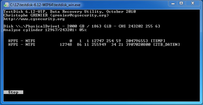

Eben bemerkt das der End-Wert "243201" nach dem Tiefenscan bei "2TB_DATEN" ja stimmt, aber Bammel die Partition schreiben zu lassen, da ich ja über "P" keine Dateien angezeigt bekomme. Tipps? Hier noch die LOG Datei
NTFS at 243201/13/12
filesystem size 3702222848
sectors_per_cluster 128
mft_lcn 49152
mftmirr_lcn 1
clusters_per_mft_record -10
clusters_per_index_record -12
HPFS - NTFS 12748 86 11 243201 13 12 3702222848 [2TB_DATEN]
NTFS found using backup sector!, 1895 GB / 1765 GiB
file_win32_pread(88,8,buffer,3907029248(243201/82/18)) read err: read after end of file
file_win32_pread(88,1,buffer,3907029248(243201/82/18)) read err: read after end of file
file_win32_pread(88,8,buffer,3907029376(243201/84/20)) read err: read after end of file
file_win32_pread(88,8,buffer,3907029504(243201/86/22)) read err: read after end of file
file_win32_pread(88,8,buffer,3907029632(243201/88/24)) read err: read after end of file
file_win32_pread(88,8,buffer,3907029760(243201/90/26)) read err: read after end of file
file_win32_pread(88,8,buffer,3907029888(243201/92/28)) read err: read after end of file
file_win32_pread(88,8,buffer,3907030016(243201/94/30)) read err: read after end of file
file_win32_pread(88,8,buffer,3907030144(243201/96/32)) read err: read after end of file
file_win32_pread(88,8,buffer,3907030272(243201/98/34)) read err: read after end of file
file_win32_pread(88,8,buffer,3907030400(243201/100/36)) read err: read after end of file
file_win32_pread(88,8,buffer,3907030528(243201/102/38)) read err: read after end of file
file_win32_pread(88,8,buffer,3907030656(243201/104/40)) read err: read after end of file
file_win32_pread(88,8,buffer,3907030784(243201/106/42)) read err: read after end of file
file_win32_pread(88,8,buffer,3907030912(243201/108/44)) read err: read after end of file
file_win32_pread(88,1,buffer,3907031039(243201/110/45)) read err: read after end of file
file_win32_pread(88,1,buffer,3907031040(243201/110/46)) read err: read after end of file
Der meiner Meinung nach relevante Teil der LOG, kann ich den Backupsektor trotz dieser Fehler schreiben, oder rebuilden lassen?

Habe deine Log-Datei gelesen.
Nach der tieferen Suche wurde deine passende Partition gefunden.
interface_write()
No partition found or selected for recovery
search_part()
Disk \\.\PhysicalDrive1 - 2000 GB / 1863 GiB - CHS 243202 255 63
Ich wußte deine Meldung nicht, warum keine Daten gelistet wurden.
Nachdem du diese wiederherstellen konntest, ist dein Problem ja erledigt.
Es gibt keine weiteren Aktionen, bis auf Backup und normale Wartung wie chkdsk um dein Dateisystem gegenzuprüfen.
Fehlermeldung mit Ext4-Sparse Superblock kann daher auftreten, da Backups in Superblöcken in Gruppen über die Partition angelgt werden.
Vielleicht Fehlerhaft und daher it wasn't enabled during compilation.
HFS-Meldung kann von Testdisk anhand von irgendwelchen Überbleibseln oder ähnlich so erkannt werden da Testdisk breite Unterstützung für Partitionstypen liefert.
Kann somit auch ignoriert werden, wenn keine HFS-Partition vorhanden war.

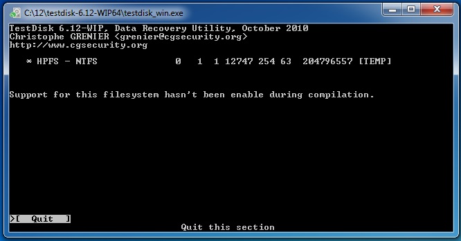

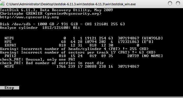

Jetzt mach ich einen deepscan auf basis von einer "None" fat basis. Er hat jetzt nach 1% das gefunden:
:freak::freak:
Und jetzt das hier! HILFE!

Du solltest auf jeden Fall den Screen nach Analyse (vor dem Quick Search!) hier einstellen, dann eine Analyse immer bis zum Ende führen, es sei denn, Hardware Fehler zwingen zum Abbruch. Partitionsstyle None an Stelle von Intel ist i. d. R. nicht zielführend und sollte nur gemacht werden, wenn Du z. B. von Fiona dazu aufgefordert wirst. Das Filesystem wird automatisch erkannt.
